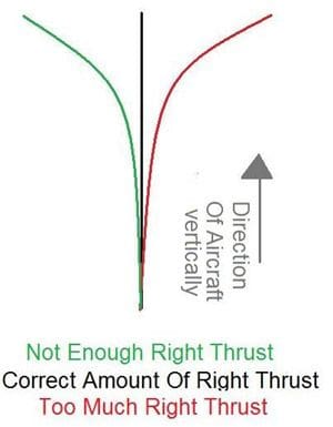

SIDE THRUST CHECK
Come across the field and pull up vertically (as if you are going in to a stall turn). DO NOT ADD RUDDER TRIM TO CORRECT THE DIRECTION OF THE PLANE – this is a common mistake some pilots make. By doing this you make more work for yourself in cross winds as you have to combat the wind and add more rudder than you should.
If the plane rolls out of the vertical to the left – you need more right thrust. If the plane rolls out of the vertical to the right you need less right thrust.
