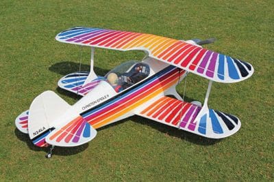

Pretty, isn’t it? Offered as both single- and twin-seater, the Christen Eagle was designed to offer build and performance improvements over Curtis Pitts’ classic bipe. They’re both lovely aeroplanes, however the colour scheme Frank Christensen chose for his home-build, twin-seat aerobatic bipe, back in the late ‘70s, must go down as one of the most iconic, indeed 30 years down the line, it’s still incredibly eye-catching.

Constructed from laser-cut balsa and ply, the airframe is nicely covered and sports that stunning multi-colour Eagle trim scheme on both upper and lower surfaces. The spats and (large) cowl are fibreglass items, the latter being supplied nicely painted and decorated. All the usual hardware you’d expect is supplied, including wheels, tank, spinner, a pre-fitted pilot figure and a fine set of instructions, for which Hangar 9 have few peers.

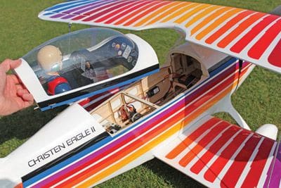

A large, removable canopy hatch provides access to the interior, and a battery tray is supplied upon which to sit the 8s Li-Po that’s suggested if an electric motor (E-flite Power 90) is to be used (see 2014 update). It’s an aeroplane for which a two-stroke isn’t even suggested, Hangar 9 clearly being of the opinion that a 1.20 four-stroke is the perfect match. And indeed it is; my O.S. has been easily accommodated within the huge cowl after a genuinely modest amount of trimming.

Construction is entirely traditional in the ARTF sense, so the Eagle comes together quickly, save a few little challenges that crop up along the way. The pilot figure was the first of these. He’s a factory fit and although made from a solid moulding is prone to coming loose, spot-glued, as he is, to the film-covered canopy interior. I made him into a more permanent fixture by cutting a hole in the base and securing him using screws fitted from the underside.
