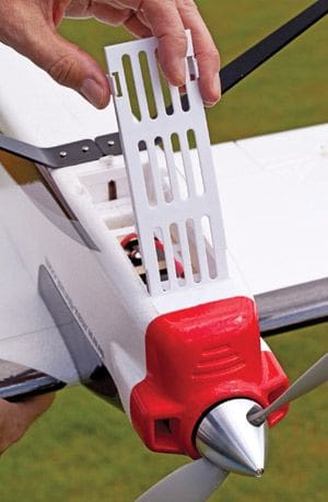

The servo count comes to four: a micro for each aileron and sub-minis driving elevator and rudder. This latter pair live in a fuselage compartment that becomes accessible only when the wing is removed, and share space with the Rx. It’s not a large area, so care is required to ensure that servo movement isn’t impeded by wires when the wing’s fitted. The Li-Po lives in a bay low down in the deep fuselage, just behind the motor. This, no doubt, helps the C of G, although some factory-added nose weight is evident. A hinged hatch lid secured with clips and a swing-retainer provides access, although (like me) you may prefer to add some Velcro just to be on the safe side.
