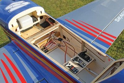

This one is for .90 – 1.00 two-stroke engines or four-stroke equivalents approaching 1.20-size. An electric conversion kit is included, too, for which the manual suggests a 50-size, 310Kv outrunner and 60A ESC, fuelled by eight cells. My version plays host to an O.S. 95 two-stroke, but whatever motive source you adopt, this is a model that’s easy to operate thanks to a large, removable top hatch that provides access to a simply cavernous interior. Moreover, the huge cowl will swallow just about any suitable engine, petrols too.

  • Although the model has been designed for standard-size servos, the cut-outs are too small for standard Futaba and Hitec units.

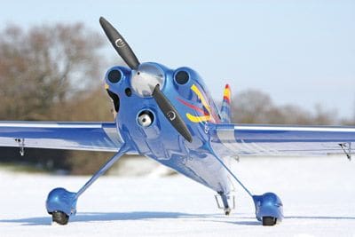

  • It’s very difficult to get everything inside the spat without damaging the part, so I suspect many builders will enlarge the axle hole or simply cut a slot. In so doing there’ll still be sufficient grip from the axle nut to retain the spat.
  • It’s important to add threadlock when securing the axle retention nut, as vibration will loosen it. Better still, swap it for a nyloc.
  • A thin ply plate is included with the u/c parts, although this is badly illustrated and described as a plywood block in the manual. The plate sits inside the spat to protect the wall when the axle is tightened.
  • Seagull always seems to suggest using cyano to secure plastic parts to a fuselage but this is poor advice, the undercarriage fairings being a case in point. Apart from the potential for unsightly glue spills and cyano mist, adhesion will prevent trouble-free removal of the u/c should the need arise. I used small screws to keep the fairings snug, with matched Oratrim tape to blend them to the leg lower down.
  • The instructions suggest trimming the axles but don’t suggest by how much. I’d recommend 50mm.

Don’t be deceived by that racy, go-faster appearance; technically speaking this is a simple, straightforward club aerobat (albeit on the larger side) that’s easy to fit out. Standard servos suit it nicely (good analogues or sport digitals will do) and in this respect I used Spektrum DS821s alongside a spare Futaba S3152 to push the elevator. Speaking of which, it’s suggested that a single joiner block be used to link the pushrod from each elevator to the single pushrod that continues to the servo. Letting a 9 lb 4oz (4.2kg) model rely on the integrity of a single, small, grub screw isn’t my cuppa. It’s far better to let one elevator pushrod continue to a swing keeper at the servo and link the second using two tight collets bathed in cyano or epoxy.

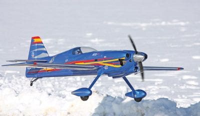

Some might be intimidated by the model’s appearance, but there really is no need to be; this is a smooth and precise sport aerobat that any good intermediate or experienced pilot will enjoy. It’s very forgiving, too; far more than its looks might suggest. I pushed the boat out a bit with my choice of engine but I’ve been very pleased with the performance and reliability of the O.S. It’s a perfect match for the airframe to the extent that I’d not suggest anything less than 15cc in the two-stroke department.
Take-off is a simple affair, with practically no rudder correction required during the roll and just a fraction of elevator to hold the nose up until rotation. Climb-out is very assured, and there’s a comfortable reserve of power.
Slow speed handling is excellent, and finding the stall will be a genuine surprise. Here, a gentle wing drop becomes evident only when the machine makes notably modest headway.
This is no 3D aerobat, but if you’ve seen the Red Bull races then you’ll know what aeroplanes like this are designed to do, and I’m pleased to say the MXS-R is smooth, predictable and responds well at the suggested C of G. I see little point in balancing the model behind that suggested, although moving it forward a few millimetres will do no harm.
The model hasn’t been designed to do anything other than club-standard aerobatics, so it’s really at home carving out nice big chunks of sky. There’s a notable pull to the left through the vertical and, although this is easily corrected using rudder, I may make an adjustment at the engine mount further down the line. Fast point-rolls are straightforward, but extended knife-edge reveals a strong desire to tuck in towards the u/c, so most owners will find some control coupling inevitable. Inverted flight needs just a breath of forward pressure on the elevator at the suggested C of G, whilst spin entry and exit is straightforward enough.
Bringing the MXS-R home is another straightforward task, its safe handling characteristics offering plenty of reassurance as the speed bleeds off during the final approach. As you’ll have noticed, the u/c is a pretty meaty affair, coupled with strong spats and big wheels. It’s a truly Tonka Toys approach to landing gear, so you’ve only yourself to blame if anything bad happens when the wheels meet the ground.
