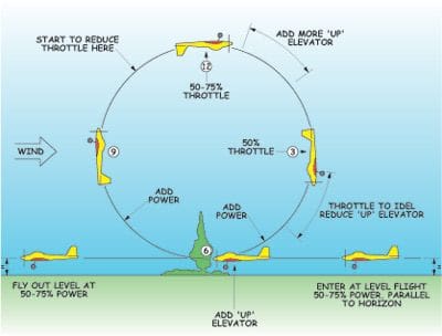

Correct entry and use of power is important. These factors are variable and can alter a little depending on the power available and the model type, so treat the following notes and illustration as a guide and experiment yourself.
Using a 12-hour clock face to describe the position of the model at any given time (Fig. 1), approach the bottom and start of the loop (6 o’clock) with level wings and in a straight line at average speed, using in the region of 50 – 75% power. A second before hitting the bottom (and centre) of the manoeuvre according to your landmark, gently but confidently pull in some up elevator. You’re likely to reach the required elevator input by about 7.00 – 7.30; add in some more power around this point as the nose-up attitude will begin to cause momentum decay.
At 9.00 the model is vertical and probably at full power. You might need to reduce the elevator a little if it’s windy – in this position the model may be pushed into the loop. In relatively calm conditions and under normal circumstances you just hold on. At 11.00 – 12.00 begin to reduce the throttle.
At the top of the loop the power should be back to around 50% – 75% and the model should line up with the centre marker on the horizon. If not then the first part of the loop has gone wrong somewhere. Assuming you’re on track, begin to pull back on the elevator a little more (adjusting as necessary to counteract wind conditions), gently but confidently increasing the input through 1.00 and 2.00. By 3.00 the throttle should have been decayed to 50%, with idle occurring at between 3.00 and 4.00.
Approaching 4.00 the elevator input is relaxed a little as the wing begins to attract more lift and the model tries to fly into the loop. Start to increase the throttle soon after, at about 5.00, so that when the model is back at the bottom it’s at the original power setting for straight and level flight.

A true vertical ascent or descent demonstrates this well. A pure vertical ascent in zero wind conditions would have the model pointing 90° (i.e. perpendicular to the ground) as it heads skywards. Add a force 5 wind, and in the same attitude the vertical ascent might start on the left side but finish on the right as the wind blows the model downwind. To prevent this the nose of the model is angled into wind a little (Fig. 2), so that it’s not perpendicular to the ground. The result is that the attitude of the model isn’t vertical but the flight path is. The same applies to a more subtle extent around a loop; you must manage the controls effectively to prescribe a circular flight path and not necessarily a manoeuvre where the model is pointing precisely forward the whole time.
