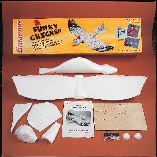

After getting the box home and having a closer inspection of the parts and instructions I reckoned this could quickly become the shortest review in RCM&E history! Even if the building instructions were copied straight into the review it would still only amount to a thousand words. Seemingly, this model wouldn’t take long to put together.
Using 5-minute epoxy it took just two hours to finish, ready for paint – the application of which actually took as long as the build. By the way, don’t worry if the thought of having to paint puts you off, read on and I’ll explain two alternatives.
Okay, on with the assembly. In total there are 6 injection-moulded polystyrene parts that make up the model, coupled with some die-cut birch ply parts, a small bag of accessories and a set of pushrods – that’s pretty well it.

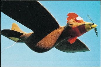

With all seemingly well I went for a powered flight. Even though the evening was flat calm, only a gentle throw was required to see the ‘Chicken head skywards at quite a pace. Now, if you like lots of stick movement with your models, be warned, because this rudder / elevator job will act more like an IFO (Indoor Flying Object). As such, you may need to use rates or, do as I did and slow the model down to half throttle soon after launch.
The first thing I noticed was the agility of the thing. Having rudder and elevator as primary controls doesn’t reduce your ability to have fun.
After gaining some height (still on half throttle) the hen was trimmed out to fly hands off. Although I personally like a large amount of stick movement for control of my models, reducing the rates was only going to reduce the amount of fun, so I didn’t bother. After a very careful flight of circuits, finishing with a climb and glide lasting 10 minutes, a safe landing was achieved and I decided it was a time to return the ‘Chicken safely to its coop ready for the obligatory photography.

The 8-cell pack gave the ‘Chicken loads of power, indeed a gentle throw saw the model climb away quickly and achieve enough height to give the option of throttling back as soon as the first turn was entered. Due to the tip dihedral the ‘Chicken is quite stable, especially in the turn. There’s certainly no tendency to lose height when rudder is applied, which reminds me of Junior 60 flying characteristics, but that’s where the similarity ends! With maximum rates the model has great agility, in fact, performing a rudder-induced roll is very easy (would love to see Christophe Paysant-Le Roux at the helm doing his famed Funky Chicken four-pointer!).
There’s no doubt about it, the looks of the model are unique and flying it does give a real sense of pleasure. The light wing loading will allow it to thermal in the right conditions and at this point it takes on the looks of a real bird of prey. A few words of caution, though: Do remember to double tie the elastic band that secures the top access hatch. If this is too loose the hatch will lift and turn into a very effective air brake, sending the model into a stall. Also, the fin (wattle) that sits under the chin will get pushed backwards into the foam on landing; gluing it at a reclined angle overcomes this.
