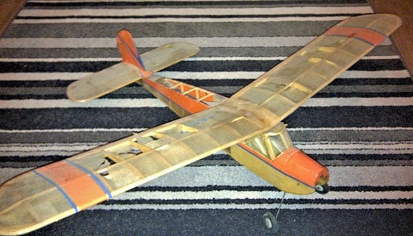

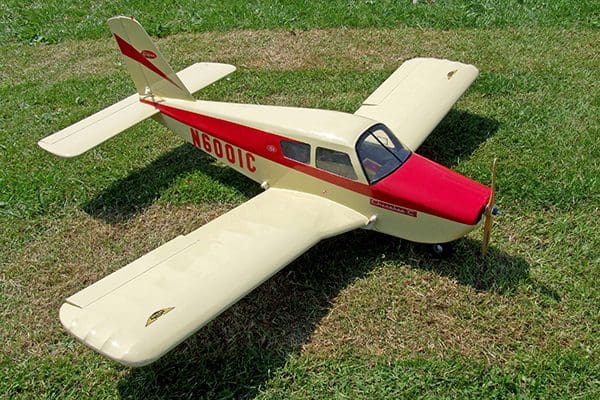

A favourite ‘silk purse’ model is my third scale Cub, modified to be the ‘clipped wing’ version so it would just fit in my car.

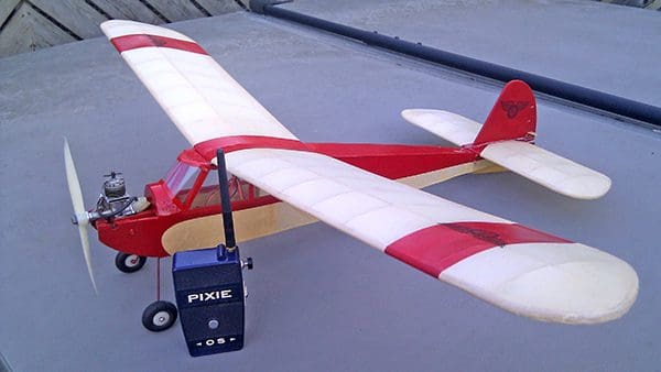

Magna finished and ready for flight using a 2.4g converted OS Pixie for rudder only. The new old stock Frog 80 burst into life after a few flicks.

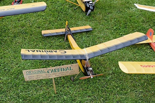

Phil Smith’s original Cardinal that he displayed with other models from the Veron range at many model shows around the UK. It is now owned by Ali Machinchy of Al’s Hobbies.

PIPER CUB
Not what you would traditionally consider retro, the third scale Piper Cub (originally manufactured in the early 1930s by the Taylor Aircraft Company and designated the E-2 for the bargain price of $1,325) was next to be resurrected. However, here’s another sad story. I was told by the vendor that it had been professionally built and covered and was an ex-display model and never crashed.
jul21ramblings10
After many, many hours working on this Cub I’ve ended up with a model I’m proud of.

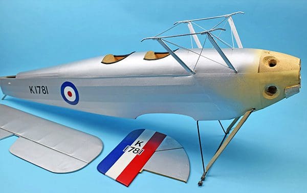

This Veron Tomtit was another ‘Bring & Buy’ bargain. Originally looking nothing like this, it’s now well on the way to being flight ready.
Another Nat’s ‘Bring & Buy’ purchase, the Tomtit was a job lot that included a mostly built airframe, an unbuilt kit and a spare basic fuselage. The airframe, constructed around 40 years ago, was accurately built and still in reasonable condition. However, it was obvious every glued joint would need revisiting as a slight knock caused a worrying number of stringers to ping off. Countless hours using penetrating aliphatic and thin cyano glues eventually did the job.
Originally the model was supplied with heavy weight tissue in the kit, but most examples were covered in traditional nylon and dope. Mine used Solartex heat shrink to help save weight.
One of the worst jobs was getting rid of all the rust on the piano wire components prior to painting, as some of the soldering was decidedly suspect. I have a confession, however; my mate Gary (who built last month’s free plan Nieuport 11) offered to get it to the finishing stage for me, so I’m going to actually enjoy sorting this one out.

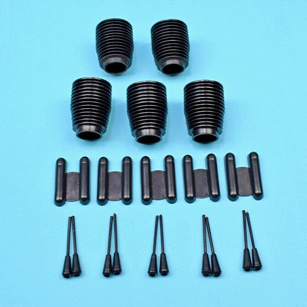

In pre 3D printing days a set of moulded cylinders would save you hours of work when replicating a radial engine.

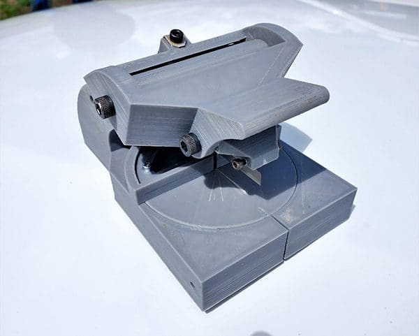

A couple of years ago I included a photo of a free flight ornithopter designed by Neil Lockwood flapping away at the UK Nationals ‘Chuck & Duck’. At the time Neil had just started his new hobby of 3D printing and he utilised a few bespoke components he’d designed on the model.
I recently bumped into him again at our local slope soaring site and his old grey matter had been working overtime. Looking like an old school hole punch, Neil’s latest widget will cut sheet and strip balsa at various angles up to 1/4-inch, I believe. He was keen to stress that this was the Mk.1 version and a more elegant and quicker to print model was in development.
jul21ramblings24
Neil Lockwood’s 3D printed gusset and strip cutter works well.
This would be an absolute boon for the traditional aeromodeller to produce accurate parts. I’ll have to see if I can convince him to release the print files when he’s finalised the design.
