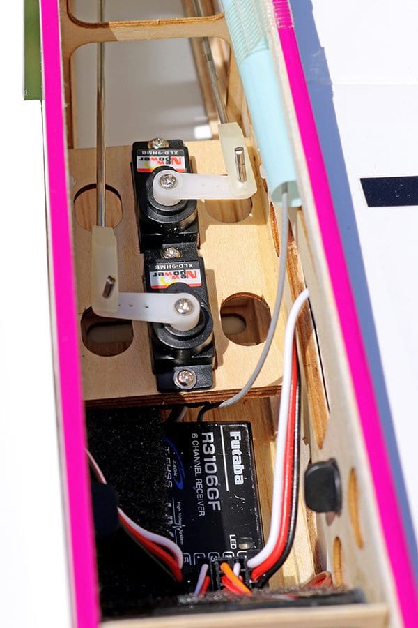

This is a model for good 9g digital micro servos with a minimum 2kg torque, perhaps something a fraction larger such as the 11g New Power XLD-09HMBs recommended.
sept20bolero4
I just happened to have the servos suggested so in they went. The long canopy hatch means everything is to hand.

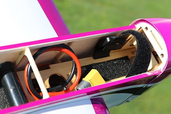

The battery bay. Anything in the 1300 – 2200mAh 3S range will fit, although I prefer the smaller, lighter packs.
I used the 11g New Power units suggested by Ripmax but found all servo recesses a shade too small to accept them, so a little trimming was required.
sept20bolero9
Servo holes need a bit of trimming to fit the recommended New Power units.

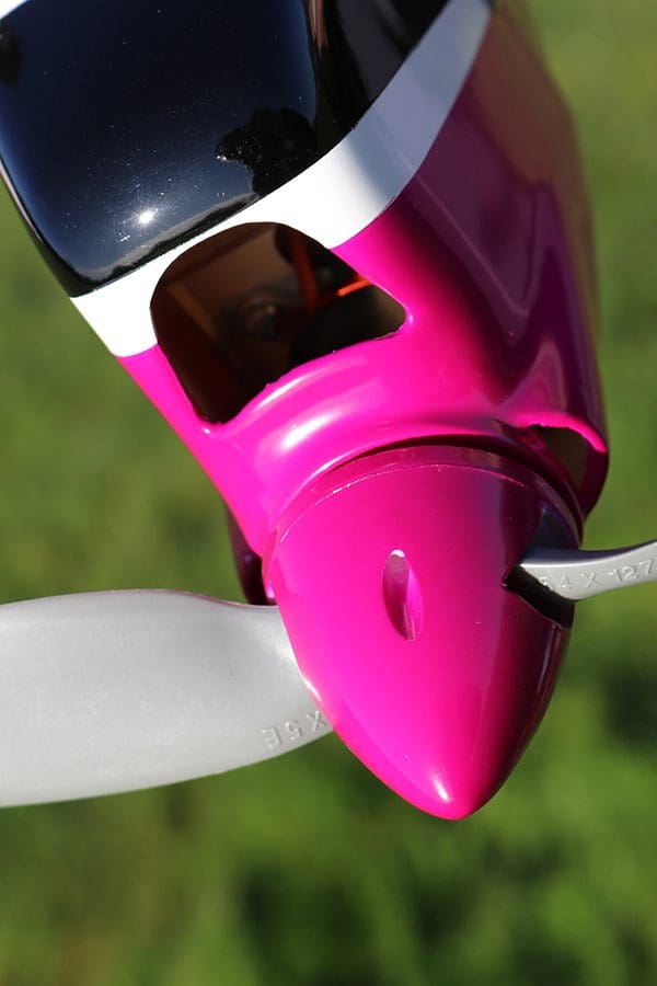

That 37mm dia. colour matched spinner looks nice but adds a chunk of vibration and noise when the prop moves. The backplate is the culprit and I’ve since replaced it with a carbon effect 38mm metal backplate number from the Irvine (Ripmax) range.
sept20bolero8
Colour matched it may be but my spinner backplate was poorly balanced. I’ve since replaced it.

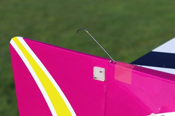

A thin wire tail skid is supplied, although the fixing method suggested (CA adhesion) won’t retain it for long. I’d suggest clamping it with two offset servo screws instead.
sept20bolero6
Using cyano and, in my case, a little tape to secure the tail skid isn’t enough. I’ve since used a couple of offset screws.
