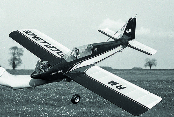

Our only colour image of Excellence is this one from the front cover of Radio Modeller.

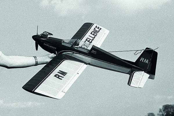

Matthew Boddington with the prototype Excellence. It was actually test flown using a HP 21 four stroke motor because Dave had claimed the OS FS 20 for the Whisper.

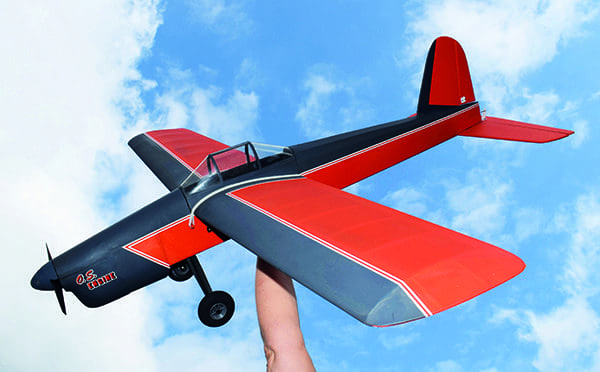

Another shot of the refurbished Whisper from RCM&E Oct 19’s feature. It was my intention to replicate the colour scheme for the Excellence.

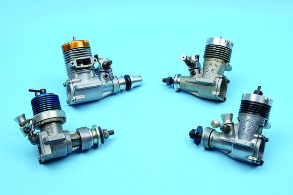

Up front, the HP 21 four stroke was heavier and physically larger than the OS FS 20. It had a more robust, industrial look but was available before the OS.

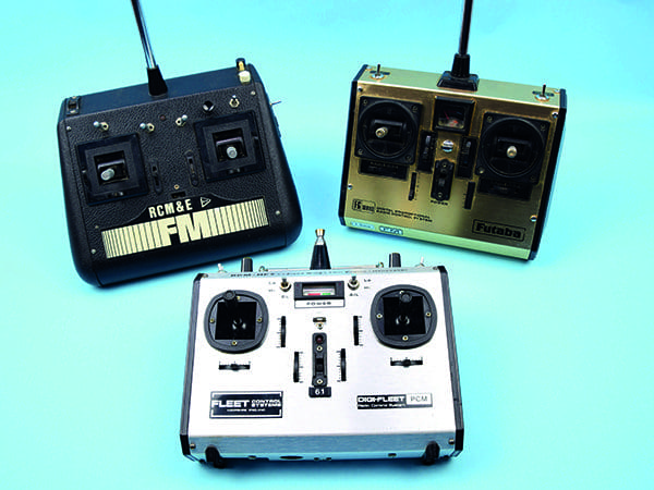

Popular transmitters from the 1980s. Top left is the Mk 3 RCM&E kit-built unit, top right a Futaba and bottom the Fleet PCM set.

Life is much easier today when setting up a Tx. In the 80s there were pots to twiddle and no model memories. Home constructed radios were popular – I went overboard with my RCM&E set and put in every available option!

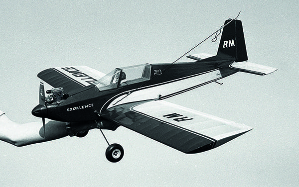

Check all the usual things such as C of G, the control surfaces move as expected, nothing binds, servo and surface horns have been tightened up and the wheels don’t bind. Boddo noted that Excellence
“…had good positive control response but was in no way twitchy. She can be pulled around the sky in tightly banked turns without fear of high-speed stalling and it’s possible to fly a display routine in a very small box of air. Inverted performance is fine, and Excellence will execute flick manoeuvres.”

If you don’t have a .20 four-stroke available then .15 two-stroke glows are easy to come by – if you don’t already have one. It may even date from the same era as Excellence!
