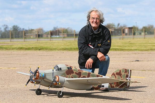

Although he is Editor Emeritus of Aviation Modeller International magazine, noted scale modeller Ken Sheppard is these days probably best known as organiser of the very popular ModelAir events at Old Warden. However, Ken has a bit of a penchant for SM.79s. After all he has built three! The first was an electric powered own design of about four-foot span. He then constructed a larger one, built from a greatly modified ARTF twin.
sept20magic2
Ken gives scale to his 100” (2.45m) span Savoia Marchetti SM.79.
Ken notes that both had high wing-loadings and quick arrival speeds. Indeed, one was lost in a tip-stall on the final turn onto a landing approach. At this point Ken decided that his third SM.79 should have a lower wing loading! This third SM.79, covered here, has its own interesting history, as Ken relates:

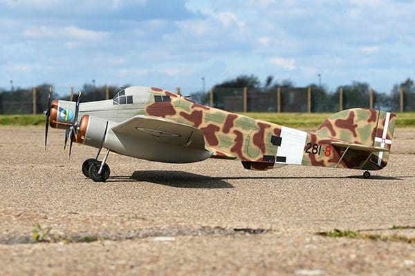

“Quite a few years ago I received a large kit to review, the Seagull Models Miles Sparrowhawk, a 30cc powered ARTF, spanning about 80. This flew very well for a couple of seasons until, as it was looking quite tatty and I needed the engine and radio for another project, it ended up stored in my shed. I had ear-marked it for a makeover sometime in the future.
Last year, carrying out an infrequent ‘clear out’ of the shed, the sadly neglected, but perfectly sound airframe came to the fore and the decision to ‘move it on’ or ‘do something with it’ was made. At the same time, I happened to find my copy of the Signal-Squadron Publications ‘In Action’ series for the S.79 in a pile of old mags. I have to say that I’m a great believer in co-incidences and thumbing through the book, the fact that the name Sparviero means Sparrowhawk and that I had a Sparrowhawk airframe, albeit the Miles variety, was too much of a co-incidence to ignore.
Getting out the tape measure and calculator, a few quick measurements and calculations gave me the idea that I could have my larger, lighter SM.79. It meant major surgery, but it would still be quicker that building from scratch – and it would give new life to the old, tatty ARTF…”

Like all who saw her, I was fascinated at Ken’s highly creative recycling of an old ARTF airframe. Indeed, I suspect that most of us have such relics lurking in our shed. The model uses the ARTF wings (with tip extensions to increase the span), the tailplane (modified tips and new elevators) and the fuselage (narrowed and reshaped with profile-altering inserts). Ken then fabricated a completely new fin and rudder.

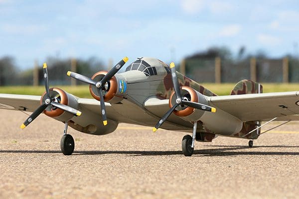

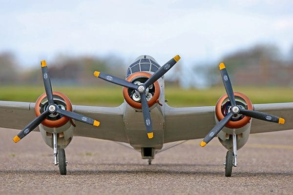

Ken soon decided that electric power was the way to go. He chose three .60-sized out-runners. The three motors develop more than enough power whilst giving the necessary up front ‘weight’ to help balance the model at the correct Centre of Gravity.
sept20magic7
Trimotors are always fascinating.

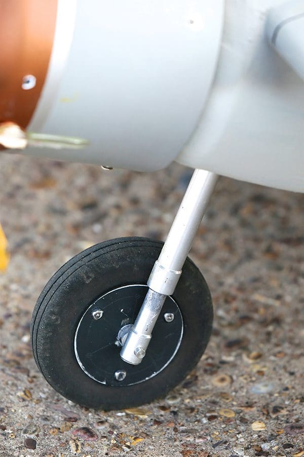

Getting the nacelles and retracts correct formed a significant part of the conversion, since the wing-mounted nacelles have to carry the main undercarriage. These comprise a pair of pneumatic and sprung oleo retracts.
sept20magic8
Ken’s SM.79 has spring/air retracts in the nacelles.

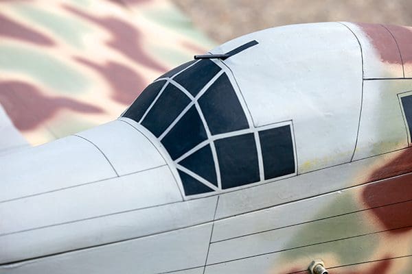

Ken intended to mould a canopy/top hatch from acetate but ended up carving one from blue foam and painting on the glazing. As Ken points out it is cartoon scale after all…
sept20magic10
The top front fuselage is quite a complex shape. Note the gun – there’s another at the rear!

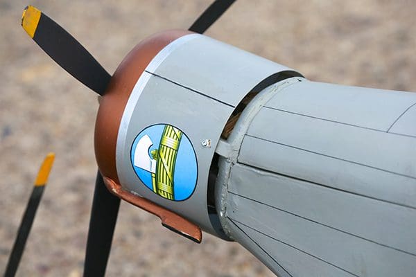

Cowls were supplied by Vortex Vacforms.

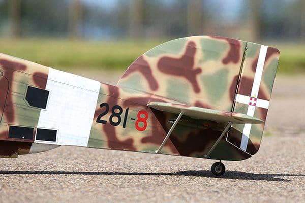

Ken’s rendition of the tail. Note dual struts and the slim rudder.

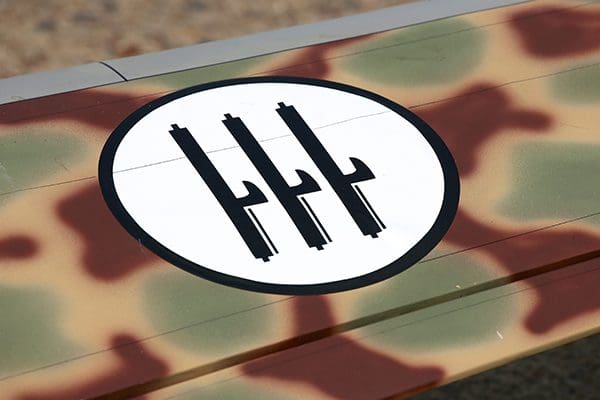

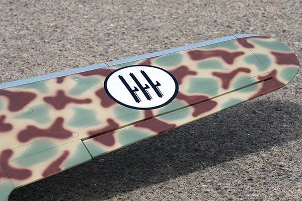

Roundels and cowl insignia use a variety of fasces symbols. Pyramid supplied the vinyls.
Pyramid Models supplied the decals at a very reasonable price, with a very quick turnaround.
