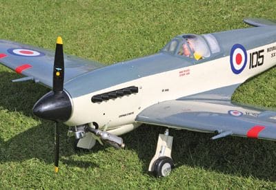

From the Mk.1b through the most prolific Mk.3 to the ‘ultimate hooked Spitfire’ that was the type 47, there’s no denying that the Supermarine Seafire deserves to be modelled far more than it is. Overshadowed by its more glamorous land-based sibling, I think it makes a nice change from the norm. Good news, then, that E-Scale has produced this ARTF version, the markings of which are based on the full-size F17 SX336 based at North Weald. That said, from a true-scale perspective the model lacks the bubble canopy and prominent cylinder head bulges above the exhaust stacks, yet as a stand-off / semi-scale rendition it does a generally decent job.
GIANT IN THE OFFICE
Distributed in the UK by J. Perkins, this 64.5” (1640mm) Seafire requires either a .75 – .91 two-stroke or .91 – 1.20 four-stroke, and is suitable for 6-channel R/C operating eight servos. The kit, complete with a set of mechanical retracts, arrives well packed and protected within a large box, the airframe being of built-up balsa and ply construction. The Oracover finish had a few wrinkles (no doubt caused by humidity changes during the model’s long journey from the factory in Vietnam), however a factory-fresh finish was soon restored with a few iron passes here and there.
A pilot figure is pre-fitted but, alas, he’s very big for what amounts to a 1/7-scale model. It’s an inconsistency that reinforces the model’s sport-scale status. The canopy is pretty well glued and screwed, so swapping him out for a figure nearer the correct size runs the risk of spoiling the model’s finish. Not worth it in my opinion, but it does beg the question why a pilot of the proper proportions couldn’t have been fitted at the factory?

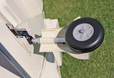

The retracts need hardwood packing blocks to be glued to their mounts before being installed, although I found that an additional 3mm packing piece was needed to ensure sufficient room in the wheel well for them to fully close and lock up. The retracts are tilted forward quite prominently to give a more scale appearance when deployed, which also positions the wheels in front of the C of G to mitigate against any potential nose–over tendencies. The retract units, although of the budget type, are sturdy enough and operate well, although the 2mm pushrods supplied to activate them are, perhaps, a little thin for the task. I managed to bend mine a couple of times when operating on the bench and catching the wheel on something. That said, they were easily straightened and, to be honest, there hasn’t been a problem when flying the model.
Each sprung oleo leg consists of a short length of 5mm piano wire at the retract end with a turned aluminium boss that fits into a 12mm long x 1mm wall thickness aluminium tube, held in place at the top with three grub screws that lock onto the piano wire. The sprung end is simple, albeit a little agricultural looking, and although they worked okay on the bench, I wasn’t convinced at all that the oleos would stand up to much.

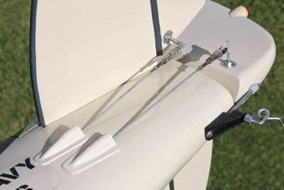

Nicely formed ABS u/c covers add to the scale effect and look really good, but do seem quite fragile and may prove vulnerable to damage.
Moving on, the ABS radiators and gun bulge mouldings need trimming to size before being glued directly onto the covering, the instructions suggesting cyano for this job. It’s not the best method but seems to work fine in practice.

My earlier suspicions concerning the strength of the oleos had been justified, which is a shame as they let down what is otherwise an excellent model. I’m very lucky in that I have access to a lathe and it didn’t take long to turn up a couple of replacement oleo legs from bright mild steel, which have since proved well up to the task. Subsequent flights have highlighted that the flaps need a touch of up trim compensation rather than the down trim I suspected. This, then, suggests that the flaps are working as drag producers rather than lift producers.

This is a fantastic model and well worth the money in my view. It’s a pity about those shockingly weak oleos, which are the model’s only weakness. Ground handling is simply superb and the flight characteristics are excellent: really docile and forgiving. She’s not a trainer by any means but is a really nice, well-made semi-scale model for year-round use that any intermediate flyer could take on without any trouble at all.
