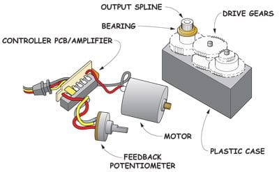

ANATOMY
No matter what the size or type, the components that make up a servo are practically the same, and knowing what these parts are will help you make more informed choices on what servo to buy.
Circuit board. This is the servo’s brain, taking incoming signals / pulses and converting them into a corresponding voltage that’s passed to the motor, which in turn drives the output shaft. The circuit board is the main difference between the digital and analogue servos mentioned earlier. On an analogue servo, the controller sends power to the motor about 50 times per second – considerably slower than the 300 times per second of a digital servo. This, then, is why digital servos are more accurate and better at responding to inputs and holding position. It also explains why they consume more power.
Motor. The motor turns the output shaft, usually via a series of gears (more on that in a bit). Most servos use a simple brushed motor, although more expensive examples use coreless motors. The advantages of a coreless motor over a brushed motor of the same size are greater longevity, faster response times and more torque. Nothing comes for free, though as coreless motors are more costly due to the use of more expensive materials. Oh, and they also draw more current. Notwithstanding, for high performance applications, coreless motors are the way to go. It’s unlikely that anyone reading this won’t have heard of brushless motors, which have elevated electric models to unprecedented levels of performance, indeed brushless motors are now finding their way into servos, offering even better performance and longevity than coreless motors yet equalling the low power consumption of a brushed motor.
Knowing what's in the case can help when it comes to selection.
Gears. The motor alone isn’t strong enough to turn the output shaft directly, so a series of gears are used to increase the torque. The way in which a servo is geared directly affects the speed and torque rating, and it’s common practice for manufacturers to take a servo and gear it slightly differently to produce either more torque or speed, and then sell it under a different name. If you shop around you can often find ‘high torque’ or ‘high speed’ versions of a given servo.
The gears in a servo are generally made either from a plastic (often nylon) or some form of metal. Plastic is good for many club models, but if you’re flying something aerobatic with big surfaces, or maybe something fast like a jet, then metal gears are the way to go. 3D helicopter pilots also favour metal gears.
Naturally metal gears are much tougher than nylon and less likely to shear or shatter. A variety of metals are used; brass, steel and titanium are prime examples, and some servos use a mixture. All metals work fine to start with, but expect brass to generate slop quicker than the others, especially if used in a high vibration environment, e.g. a model with a petrol engine. Titanium, on the other hand, has great longevity and I rarely hear of any serious slop developing with these gears.
Metal gears cost more and don’t tend to mesh as well as nylon gears, so expect a tiny bit more play than a plastic-geared servo. In my F3A models I actually prefer plastic gears for this reason, since a good nylon geartrain is virtually free of any slack. You’re probably wondering how I can get away with using plastic gears in an 80” (2m) span aerobatic model? Fact is, you don’t use a great deal of throw in F3A. Even for things like fast snaps, plastic gears seem to hold up fine. But for 3D models of around the same span and beyond I always go for metal if I can. In fact, I’ve stripped plastic gears in 3D models as small as 40” (1m) span!
The output shaft on a metal-geared servo is also metal, so be sure to apply threadlock when securing the servo arm so that the retaining bolt doesn’t vibrate free; this can (and does) happen. Never use threadlock on plastic-geared servos mind, they don’t need it and threadlock can corrode the plastic. If using a metal-geared servo it’s best to use a metal servo arm, too. You can get away with plastic, but when fitted to a metal spline, these can strip.
Potentiometer. Also known as a ‘pot’, this is basically a variable resistor which, as it’s rotated, alters the voltage passing through it, and is used in servos to feed the position of the servo arm back to the controller. The pot is connected to the output shaft so that as the servo arm moves so does the pot, by the same amount. By measuring the voltage passing through the pot, the controller can figure out where the servo arm is. If this is different to where it should be, then the controller keeps moving the arm until it’s in the right place.
Pots do get worn out over time and can get dirty, thereby delivering erroneous readings that can lead to jittery or inaccurate servo operation. A bad pot is a rare occurrence, though.
Output shaft. This can be supported in one of two ways, either by the case itself (sometimes with a metal insert to act as a bush) or with a ball race bearing. The latter is better, offering less resistance, less play and much reduced wear. Some premium servos use two bearings, supporting the shaft at both ends.
