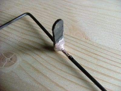

The hottest part of the flame is at the tip of the bright cone of the flame. Take a piece of brass tube and apply the flame to it. You will soon see that when the tip of the cone is just touching the metal, the tube will glow red but as soon as you move it away the glow will vanish. A good joint will have a smooth finish and should flow or blend out onto the metal surface. Poor joints will be blobs that do not blend into the metal. Poor joints may be caused by dirt or insufficient heat.

The finished silver solder joint on the control horn
