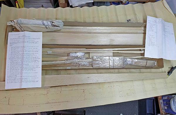

Where to start? Andy had said the kit was complete, but still my first step was to go through the kit part by part to see for myself exactly what I had. True to his word everything was there. The two fuselage sides had been started but looked a bit grubby from their time in the loft. However, they would clean up.
mar21sailman4
Kit open and ready for inspection.
The only real issue, as Andy pointed out, was going to be the plans. The dye-line prints had become extremely wrinkled over the years. Sheet one was also very badly faded and unreadable in parts where it had been left out in the sun light.

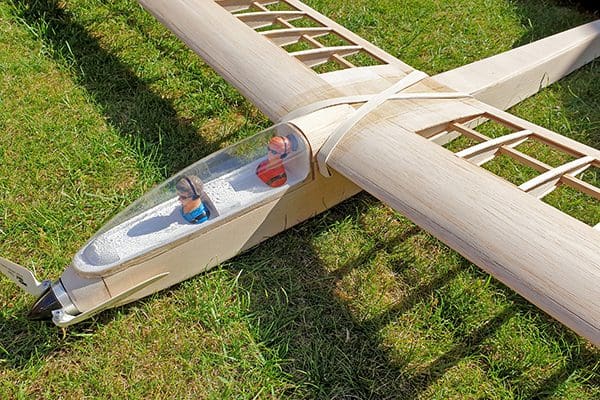

The model itself is as traditional as you can get, with a box type fuselage fitted with formers, doublers and triangular longerons. The tail is all built up from the strip wood supplied.
The wing is built up in four parts, with the two centre sections being joined together with a ply joiner and the two small outer panels being removable. The wing build is straightforward, with the ribs and spars being laid over the bottom leading and trailing edge sheeting before adding the top sheeting and capping strips.

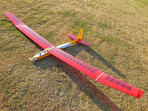

The elegant glider basks in the late summer evening sun.

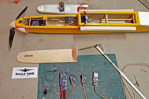

With the wings and fuselage built, covering and radio fit were next. The instructions say to use the covering of your choice, so Oracover it was. I used transparent on the wings as I didn’t want to hide all that lovely balsa, especially when I had taken the time to get it right.
Radio fit didn’t take long, with only two mini servos, a receiver and ESC to install. I did swap out the old plastic snake inners in favour of carbon rods, my last concession to current times. I don’t think there was anything wrong with the old plastic inners as on inspection they looked perfectly serviceable, but I decided not to take that chance.

A new canopy was made to house an Eagle Tree flight logger.

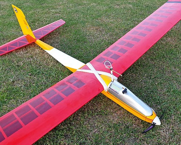

Second time out was much better, with the glider now looking resplendent fitted with new Cam Prop blades. This time I was joined by George Worley (a.k.a. Mr 4-Max) and Colin Low, whom I must thank for the flight photos. It was late evening, about an hour and a half before sunset. The sky was cloudless and there was not a breath of wind and no thermals to be had. My first two proper flights were spent getting to know her, with multiple climb and glides.
mar21sailman11
Ready to go with the eLogger and a small camera installed.
Despite the down thrust I had added to the front bulkhead, under power she wants to pitch up, taking about half the available down elevator to keep it in check. Note to self: adjust the down thrust or add a throttle elevator mix (except that’s cheating as we didn’t have mixing back in the day. Well not on my MacGregor Digimac III anyway!)
In the glide it’s a big pussycat, with the control throws set up as per the instructions. If anything, the rudder was a bit too soft for me, needing large stick inputs to start and stop the turns. Once in a turn just a little up elevator is all that’s needed to keep the turn going, big or small.

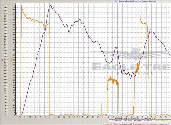

eLogger data showing the power and glide phases.

Since then, I’ve had the Simple Sailman out at every opportunity, and I have had some good thermals, to the point that she starts getting too small for comfort. The electric conversion pays dividends when the thermals are few and far between.
mar21sailman13
Four decades on the Simple Sailman still provides lots of entertainment.
After yet more conversation on the forums with Cloudriderurt, this time about telemetry, I dusted off my Eagle Tree Systems eLogger and fitted it for a few flights, just to see what she is capable of. She makes about 500ft/min on the way up and if there’s no lift about 140 on the way down.
