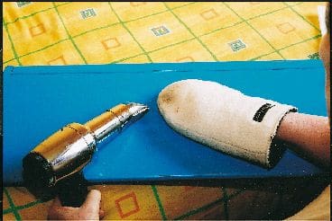

Once you’ve actually covered the model and shrunk the film to shape, its necessary to press the Solarfilm into contact with the whole airframe. You can do this with a wad of soft paper tissue or a soft cloth.For some reason, though, I’ve always found that tissue leaves a haze over Solarfilm, while a rough cloth can score the underlying balsa.
Top Flite’s Hot Glove, on the other hand (no pun intended), looks and works just like an oven glove. It protects your hand from the blast of the heat gun, while applying a gentle, even pressure on the film.

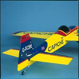

A superior finish like this is what you’re aiming for.
