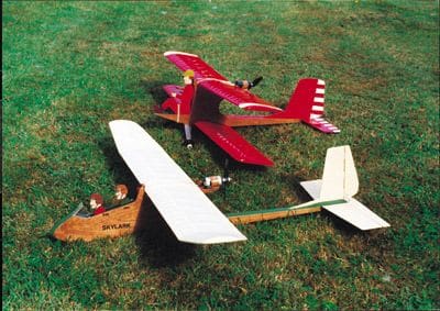

We decided that a simple electric (pusher) glider would be the best solution, and the outcome was the yellow model you see in a photo here. It proved to be a very easy aircraft to build and fly, and as a result, I decided to develop the idea just that little bit further.

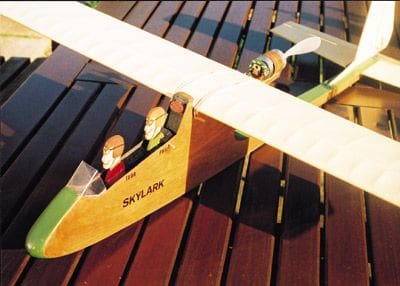

Hence, we move on to Skylark. The unnamed yellow aircraft was of entirely balsa construction with an enclosed cockpit, whereas Skylark has an open ‘office’ and 1/32” ply fuselage sides, which gives a wood-stained antique aircraft effect. A further bonus of the open cockpit is that NiCad access becomes easy, and it allows the opportunity to add some 2D ‘character’ pilots.
Antique Solartex was used to cover the wings on my model, but Philip Beard, who built another version in order to ‘prove’ the plan, covered his in red transparent film. Philip used 1/16” balsa for the ribs instead of the 1/8” shown on the plan; furthermore, notice that the wing spars are 3/16” sq. spruce – a modification made after the prototype broke its wing during a loop.

Although I used teak wood stain for the fuselage, and vintage Solartex for my wings, the flying surfaces also look nice in transparent film covering. It really doesn’t matter what you use, but if you do go for the glossy stuff, you’ll find that Diamond tape makes a good hinging medium – otherwise, you may as well opt for Mylar.
