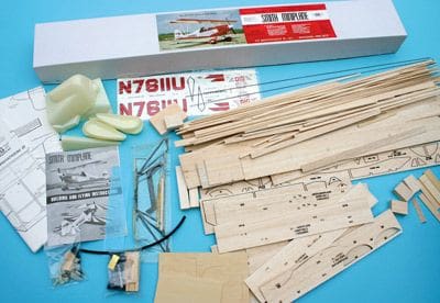

Introduced by Sig in the mid ‘70s and still in production, the Mini Plane struggles to hide its vintage. It is, quite simply, a superb example of a ‘70s US R/C kit. It has some charm though, and brought back memories of watching father build his Sig Piper Cub, some thirty years ago! At the time, I recall, I used to assemble my Airfix kits alongside his huge building board.
So, what’s in the box? Well, there’s a lot of wood! In fact, at first I though they must have mistakenly squeezed in two kits of material, such was the amount of strip, ply and balsa in evidence. Two large plan sheets, some wire and hardware, along with cowl and spat pieces made up the rest. But oh the wood! The wood! There seemed to be enough to build a half scale version, let alone this diminutive 44” example.
