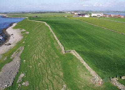

Slope lift requires movement of air by wind. In finding obstructions in its path such as a hillside, building, cliff face or even a dense bank of trees, such wind will endeavour to climb over it as shown in Fig. 1.
Fig.1.
This demonstrates slope soaring in its most basic form. The topography of the obstacle in the path of the wind defines the position, strength and the extent of the usable lift for a given wind condition, as does the type, size and weight of the glider being flown.

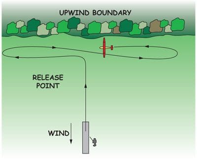

THERMAL TRIPPING
Thermal soaring requires a totally different approach, and if the flight is to be prolonged then some lift must be found. This particular discipline is about covering, and flying through, lots of air, preserving height until lift is found, and the pilot’s focus can change from searching to tracking, exploiting as much lift as possible. What he then chooses to do with the potential energy of the height gain is up to him.
A standard thermal search pattern (Fig. 5) sees the pilot coming off the line at altitude and continuing upwind towards the boundaries of the flying site or beyond. Just as on the slope, turns are made away from the pilot with ‘legs’ running across the wind. In tracking the model back and forth with minimal control disturbance, the pilot can use its behaviour to spot the effects of thermal lift. With the elevator set at a position known as ‘best glide’, ground can be covered easily for minimal height loss, and then when in lift the pilot can re-trim with up elevator and perhaps wing cambering to a minimum sink setting. Here the model’s glide is flattest and slower, but it won’t cover ground so well. Nor would you want it too! Having just found the lift you’ll want to keep with it as long as possible by tracking it as it travels slowly downwind.
