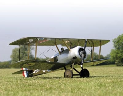

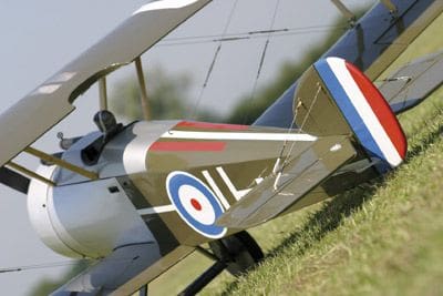

With all the normal ground checks made, the Camel was ready to fly. Not, I hasten to add, before a few static photographs had been taken and wed had an opportunity to see our esteemed editor as you’ve never seen him before, laying face down on the grass surrounded by sheep droppings. Cries of, Maybe they’re camel droppings? and Do you think hes fallen asleep? were heard, but he defiantly maintains that good pictures take time.
I have to admit the Camel looks a treat just sitting there on the runway. The only unfavourable comment was that the finish was too shiny. At that point another modeller put forward the theory that the original Camel would have had a gloss finish having been covered in banana oil or dope. As if to add weight to the argument, there was also the suggestion that matt paint hadn’t been invented in 1917. Anyway, for me she looked the part.
Facing straight into wind and with the pilots scarf fluttering in the prop-wash, it was time to push the stick forward and head down the runway. Take-off was very simple and not as Id anticipated. The tail lifted fairly quickly and the rudder had authority. I found the model easy to control with no signs of any ground looping. Into the circuit, then!
After a few minor trim changes that were easily achieved without any outside assistance, she flew straight and level adopting the right attitude and sit in the sky. Flying for the camera is always a good indication of how well a model behaves and in this case the Camel will go exactly where you put her. Low passes were the order and here she looked formidable and had all the atmosphere of a classic W.W.I mount. With the photos done it was time to land and refuel. On reducing the throttle the large nose, two wings and rigging wires slowed the aeroplane quite quickly, so if youre not used to draggy biplanes, try this with some height first.
I anticipated a difficult landing but provided you take into account the drag factor there really isn’t a problem. Don’t let her bounce too much and try to have both wheels touch at the same time otherwise, with that long undercarriage, shell start to oscillate from one wheel to the other until the wing tips strike.
