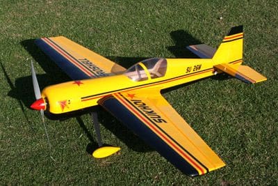

Pretty thing isn’t she?
Overlander’s 30-size electric aerobats aren’t new, they’ve been around for a year now and the 6 models in the range have been very popular. Price has something to do with it, with the exception of Seagull’s slightly smaller Extra and Edge, you’ll be hard pushed to find a comparable 50″ span, lightweight electric aerobat for the money.
A spell of over-exuberant flying ‘retired’ my much-loved SebArt Katana recently; the options were stark – pay £70 for this 50″ span Sukhoi or getting on for twice the money to replace the Katana. Not a tricky decision, besides which, yellow’s my favourite colour.
I’ve been told that the Overlander electric range are made in the SebArt factory a story I’d give credence with some parts bearing a distinct resemblance to the Sebby stuff. Whether it’s true or not, the quality of this Sukhoi is very good, not quite in the same league as your average SebArt machine it has to be said but fine non-the-less.

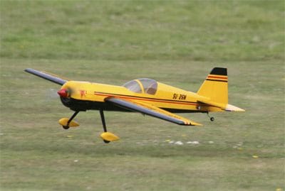

Look after the landing phase and the Sukhoi will look after you.

The model tracks a little to the left on take off but nothing that a little rudder can’t handle. To an extent the peformance hasn’t been a surprise given the ‘known’ power train but it’s still impressive non the less with a pretty unstoppable climb rate. She’ll prop-hang happily and the knife-edge is one of the best of any model I’ve flown with no coupling required (something this particular model is now well known for).
Spins are pretty frenetic with the sticks in the corners, blenders too. What’s great about the model is the she looks fantastic in 3D or ‘pattern’ mode – the Sukhoi is one of my favourite full-size aerobats so I can pretend she’s IMAC’ing when the sticks aren’t in the corners.
She’ll drop a wing when slowed down which is something to be particularly aware of when landing but generally this is a safe and pleasant aeroplane. Just to expand on that point though, the model shares a trait common to the 30-size electric aerobat in that she’ll drop the last few feet if you bring her in too slow for landing. This is where the u/c is at risk and where even a little bump can cause a dis-proportionate amount of damage to the structure. I’ve lost count of the number of flyers (myself included) I’ve seen walk out to retrieve a model they’ve assumed is ok, only to find a shattered u/c mount and crumpled fuselage structure.
Models like this clearly aren’t for beginners but anyone with basic aerobatic experience will get along with the Sukhoi. It’s vital to take things gently until you’ve establish the feel of the model and trimmed her properly and you must have the skill to land proficiently using throttle. Getting the best flying ‘feel’ is, more often than not, a case of getting the battery positioned properly. In this respect it should go well into the cavity created by the motor extension frame. Retain the battery with a releaseable cable tie and velcro – velcro alone won’t do.
