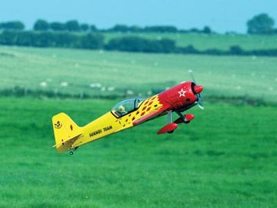

On arrival at the club strip there were many admiring glances, with many compliments for the Far Eastern workforce who built this model. I just wish I could claim some of the credit! A range test was completed and with the SC running at full bore she was pointed into wind and let go. Not much time was wasted getting airborne – the Sukhoi simply leapt into the air!
It very soon became apparent that this was one bucking bronco; very sensitive elevator control pointed to a tail-heavy model – I had a fight on my hands if I was going to rein this one in! Three or four circuits later I was ready to quit while I was still marginally ahead, but the engine quit for me when the SC spat out its plug! Tip-stalling all the way down, she came in on what looked like a near-vertical landing, just missing the biggest oak on the patch… she was down, and I was left wishing I’d donned a pair of bicycle clips…
A quick adjustment using 6oz of lead up front and I was ready for launch No.2. This time she behaved herself, and with a few flights under my belt I began to regain some semblance of confidence and settled in to what is a rather nice model, with the SC 52 providing ample power. Inverted flight needs no trim adjustment, rolls and snap rolls are fast, and inside and outside loops are no problem. Slow her down into wind at a crawl then she’ll start to waddle and slowly drop a wing, but nothing your average club flyer can’t tackle.
