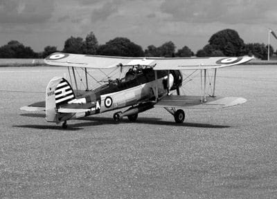

This museum-quality flying model was built by noted Nats competitor Richard Crapp, from a plan drawn by Len Ashdown of Ontario, and is based on a second TAG school aircraft, which was also being restored to flying condition. Powered by a Laser 300, 50cc ‘V’ four-stroke and guided by 9-channel Futaba radio, Richard’s superb example weighs in at 33 lb. In keeping with the full-size it has folding wings, employing a faithful scale mechanism. It contains many specially made parts, such as tyres, hubs, oil cooler and a complete Bristol Pegasus engine! All 3000 rivets in the front panels are reproduced, the stitching and taping on the wings is completely accurate, and the model has a full complement of streamline wires. The cockpit is totally complete, right down to the writing on the flare cartridge! Richard’s Swordfish is a real labour of love, taking about 5000 hours of dedication over a five-year period to complete.
CONSTRUCTION
Although you might expect such a model to have entirely traditional construction, a lot of carbon fibre has been employed, to add strength and reduce weight. For example, all the struts are carbon tubes, faired with balsa, though the wings are mostly traditional balsa construction. Throughout the model, where one would expect plywood, Richard has used his own lightweight high strength balsa / carbon sandwich technique: as an example, the firewall is a balsa end-grain / carbon sandwich bulkhead, conferring immense strength for very low weight.
The scale wing folding mechanism took nine months to organise, and has universal joints terminating all the stays. Richard reports that making the wheels was ‘a hell of a job’, particularly the raised lettering on the Dunlop tyres, which in the end was achieved by a complex mould, tooled in wood. The authentic hubs are sand cast items. Covering is Profitex from Tony Clarke’s Practical Scale which, Richard reports, sticks well and is very stable in the sun. The scale pilot shares the same leather luxury on his derrière as the full-size pilot, a detail made possible when Richard acquired some leather from the full-size during its restoration at Yeovilton.
