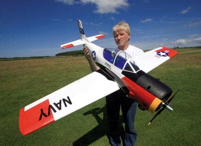

I took receipt of the kit and made a preliminary forage into the box to confirm that all the bits were present. The model, a North American T-28A Trojan, wasn’t an aircraft I was familiar with but it certainly looked neat and very chunky in appearance.

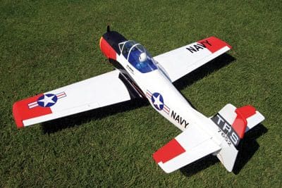

Epoxy is used to glue the wing panels, the joint strengthened by a stout aluminium tube and a dowel incidence peg at the rear. Once the glue was dry I sealed the joint with some delicately shaded white insulation tape. The fixed undercarriage mounting positions are hidden beneath the covering, which must be slit as appropriate before adding the piano wire legs. The undercarriage doors (neat though they are) are made from sharp plastic, so I nipped off the bits that could spring back and pierce the wing covering before part-securing them with tie wraps. The addition of a Y-lead completed the wing, save for the application of a few scale decals.

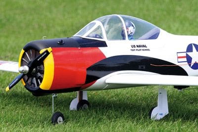

The Trojan comes complete with a beautiful fibre-glass cowl so in an attempt to do it justice I spent some time cutting and filing out holes for the nose wheel, silencer, needle valve and glow plug. If you don’t already own some, I strongly advise that you get a few Perma-Grit tools as they save both time and effort, and help create a really professional job.
I must confess here that I made a cardinal error. Perhaps I was distracted, or maybe the impending editorial deadline made me rush? Anyway, believe it or not I fitted the (almost) symmetrical cowl upside-down with the anti-glare strip on the underside. Oo-er! Fortunately I was able to paint another anti-glare panel on the top using Humbrol matt black. Still blushing, I affixed thin ply plates to the fuselage in four places to ensure a snug and firmly fixed cowl, then inserted suitable self-tapping screws.

It just so happened that this near-completion stage coincided with a gap in the club meeting schedule, which provided the opportunity for me to talk about the kit before a captive audience. The decals supplied with this sport-scale model are of high quality and I fitted them in keeping with the picture on the box in preparation for the club night. A number of members were impressed with the Trojan, commenting favourably on the laser cutting, hardware quality, covering and decals.
Three days later the Trojan’s wheels sat on grass for the first time at the club patch, whereupon I test-ran the ASP prior to the first flight. Here, I noted that the throttle setting needed a little adjustment and that the engine appeared to be revving a little fast. Nothing to worry about, though, as I have a three-bladed 10 x 6 prop that may quieten it down whilst also converting the model into a T-28B. During this testing period almost everybody at the field sidled up to ask about the Trojan, attracted by its cute, chunky and attractively rugged frame. Even Delyn jet jockey Nathan Farrell-Jones came up and asked about the neat model.
