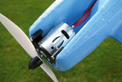

In practise a little foam cutting may be needed to ensure the wires have sufficient room and the fillet sits flush with the wing. It’s great to see that a lot more thought has gone into the wing assembly. One improvement that can be instantly appreciated is the fact that the motors are now screwed into purpose-designed mounts. On the original model the motor can was glued directly to the nacelle, making replacement almost impossible without inflicting some minor structural damage.
For the review I chose to use the standard 6V 400-size motors supplied, though do check my later comments about the motor upgrade option before making your final decision. Two bolt-down plastic clamps are supplied to hold the wing panels in place, the wing bolt mounts being moulded into the fuselage; once again, as far as I’m concerned, this is a significant improvement on the original. Fuselage construction is equally quick with pre-moulded servo apertures and appropriately routed pushrod cable ducts making light work of the radio installation. Drop in a pair of mini servos, feed the snakes along the ducts, connect it all up and the job’s done.

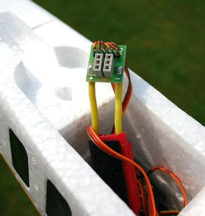

Another neat little innovation is a fuselage-located PCB that’s designed as a junction-box for connecting the receiver and speed controller to the wing-mounted motor and servo wires. It’s a simple device which has worked well for me, although I do have some misgivings as to how robust the unit may prove in the long term. Continued plugging and unplugging may find a weakness here; on the other hand, it may not! Incidentally, some clever thinking has gone into the design of this item as, whichever way around the motor connectors are plugged, it’s impossible to reverse the polarity.
