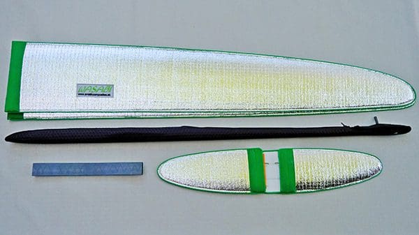

I discovered that the Wasabi had been perfectly packed. The wings and tails are delivered in nice protective bags (the fuselage bag is optional) and you will also find nice carbon servo frames and the LDS system from MP Jet, with all the necessary hardware to mount the servos in the wings. Wiring harnesses are partially prepared and soldered. The fuselage and wing ballast and spacers (joiner ballast is optional) are included and there is even a neutral adjustment template for the wing and the tail!
aug21wasabi3
Wasabi arrives with wing and tail bags. A fuselage bag is an option.

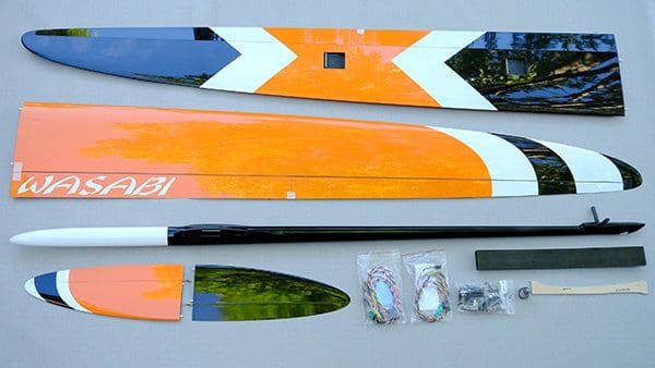

Let’s take a closer look at the moulded parts; they are very well made and nicely painted, with very clean cut-outs. The carbon root ribs are perfectly sized with holes for green MPX connectors. Even the ballast compartment and the joiner box show sharp angles and a mirror-like surface finish! The joiner can be inserted without force or slop. The wing centering pins are already in place. The wing joiner is particularly wide, in one piece and inspires trust.

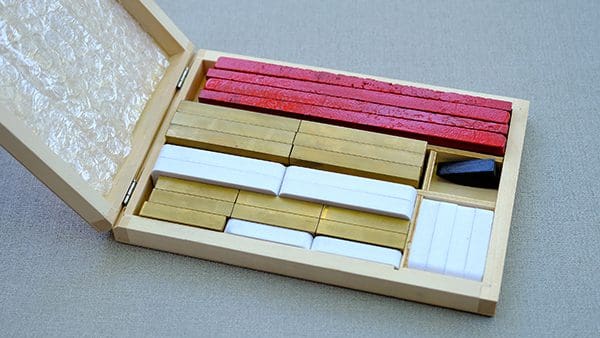

The kit is top notch quality and comes with accessories, balance lead and a setting template.
The tail halves also have carbon root ribs. Elevator horns and centering pins are in place. The only drawback (I had to find something!) is that the ball clevises are not totally freely accessible once the tail is in place – only 3 or 5 mm is missing for perfect accessibility.
Fuselage assembly is well advanced since the ballast tube is already installed and the servo plate is finished, including brass inserts for M2 screws ready to receive the servos. The fuselage join line is almost invisible, showing superb craftsmanship. Elevator control rods are made of Teflon coated fiberglass rods, sliding in a plastic sleeve. Personally, I like this solution. which I prefer to a rigid carbon rod.

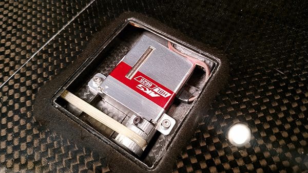

Let’s move on to the servo frames. In my case, I had to install the brass inserts for the aileron frames because the position of the screws can vary depending on the MKS servos model that you chose; I used the excellent HBL6625 mini. So, I drilled at 3 mm and then inserted the brass claw nut with a small hammer. We can now glue in the servo mounts, with the servo in place. Once dry, I could finish mounting the servos, with the right neutral position offset on the radio.

The excellent MP Jet LDS system is provided, with nice carbon servo frames for wing installation.

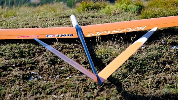

V-tail view.
