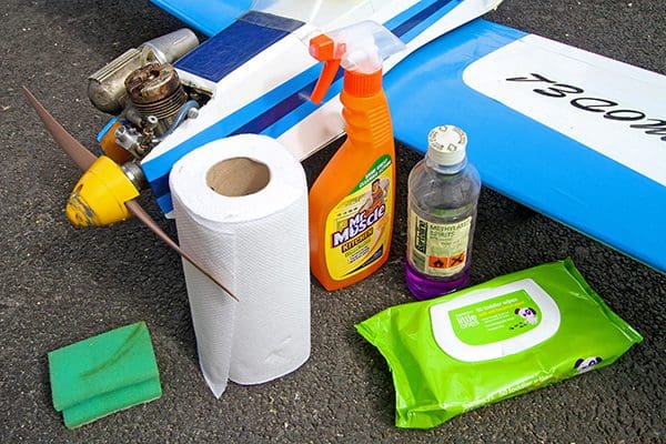

CLEANING & DEGREASING
First of all, she needed cleaning down, plus a good dose of looking at.
june21weekenders6
My basic degreasing kit.
My de-greasing kit comprised:
• Paper towels for all wipe downs
• Baby wipes for the sheep muck
• Methylated spirits for the oily bits
• A well-worn kitchen sponge pad for very light abrasion
• Mr Muscle Kitchen Cleaner
• Talcum powder
• 800 sandpaper

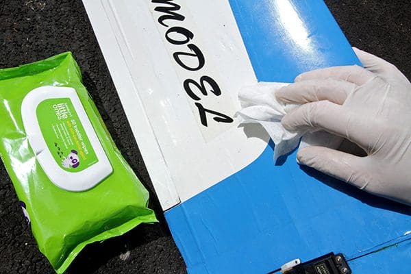

Baby wipes are great for everything from sheep muck to oily mud.

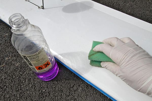

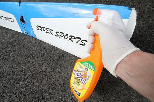

The baby wipes were used for the first rough wipe down and then I sprayed the kitchen cleaner on the grubby and still cloudy film. This worked wonders and I wiped it off with other baby wipes, then dried it down with kitchen towel.
june21weekenders8
I thought it prudent to use disposable gloves from the car accessory shop.
Stubborn grass and mud stains near the undercarriage on the lower wing were treated to the soft sponge treatment with meths. Once finished the film was given a light polish with dry paper towels. The finish was much better than I expected.
june21weekenders9
A well-used kitchen sponge and meths was needed to shift the ingrained muck.

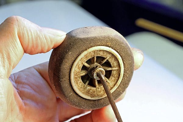

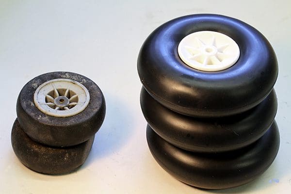

Next task was to remove the original foam wheels, since two had developed flats. At this point, with meths and baby wipes, I degreased the piano wire tricycle undercarriage.
june21weekenders10
Original foam tyres had pronounced flats.
I fitted larger air wheels, which, from experience, work well on our upland sheep farm grass. I replaced all the wheel collets and washers.
june21weekenders11
Small foam wheels were upgraded to larger air wheels.

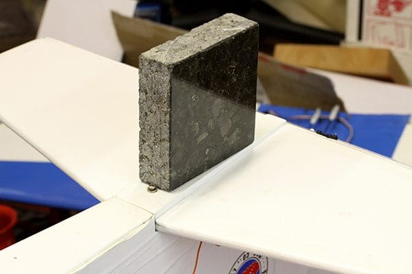

The tailplane seat needed degreasing and the old glue sanding back.
The tailplane seat was a bit loose so I eased it off with a new scalpel in my knife and dusted the newly exposed area with lots of Christmas talc to remove as much of the oily residue as I could from the balsa.
june21weekenders15
I used a good slab of weight to hold the tailplane in place whilst re-gluing.
I used baby wipes and a bit of light sanding to clean up the immediate joint area, to better key the fresh glue line. I reset the joint square with heavy weights as the 10-minute epoxy glue dried. To my slight surprise the result was excellent.

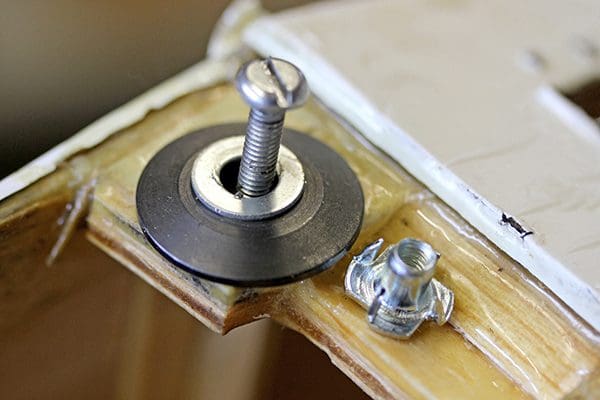

The fuselage and wing-seating areas were thoroughly degreased with meths, baby wipes and talc. There was no serious damage, but I upgraded the wing retaining nuts to new captive types.
june21weekenders16
New wing retaining hardware was fitted. I fitted bigger plastic spread washers under the wing screw heads.

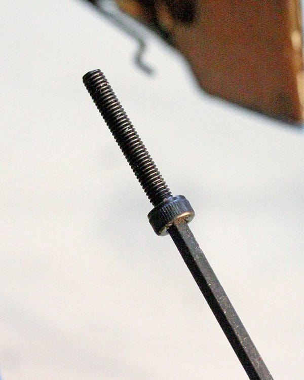

I threw away the existing Phillips head set screws and fitted new Allen key set screws. I had toyed with the idea of easy snap-off nylon types, however I reasoned that since she had flown all her high-hours with metal bolts they could remain. These latter Allen key jobs are much better ‘field serviceable’ items.
june21weekenders17
Crosshead screws were replaced with field friendly Allen screws, which stay put on the driver.
I put bigger plastic washers, backed with steel ones, onto the new wing retaining set screws. This was to pad out their footprint on the lower wing. These simple upgrades made the whole wing fitting much more rigid. I added some new wing seating tape whilst I was at it.

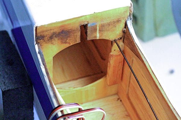

Wing locating slot was grubby and oily, but fine.
The wing locating slot, lost in the oily fuselage, was in good order and did not need any beefing up. This is something I have had to do in the past on other high-hours models.

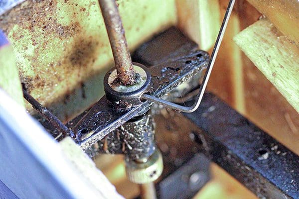

STEERABLE NOSEWHEEL

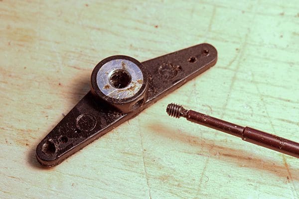

Any steerable nosewheel takes a huge pounding and many hours of my dodgy landings had rendered the original terminally wonky. It was held by a collet, retained by a grubscrew, which by now had about ten degrees of slop.
june21weekenders19
The original steerable nosewheel assembly needed some upgrades. Disassembly was messy!
After some thought I decided that it was easier to fit a new engine mount and steering arm but retain the original piano wire. I used a Nexus steering arm, drilled out a bit bigger at the collet, and then tapped for a fatter grub screw. This was to give a bit more strength to take up the slop in the slot on the original piano wire.
june21weekenders20
The new steering arm was drilled out and threaded for a bigger hole for a fatter grubscrew.
I ground a bit more flat on the undercarriage piano wire to accept the bigger grub screw. This meant disassembling the whole nose area, but it was worth it.

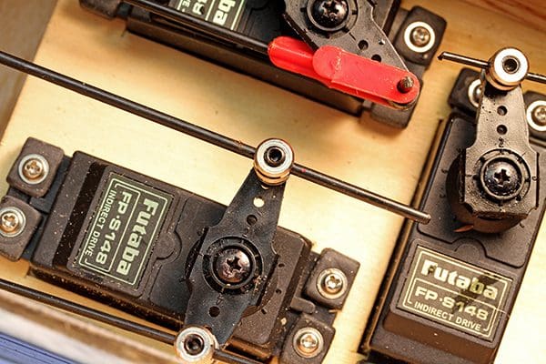

The radio installation was in good order, but I did replace all the connectors on the servo arms, as well as the aforementioned Rx battery / charge switch.
june21weekenders22
I checked over the servo installation and fitted fresh connectors.
I was amazed how well a simple plywood servo tray had taken the hammering over the years.

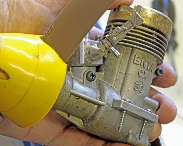

Since I had the engine out on the bench, I gave the outside a lick and a promise. However, I did check over the carburettor, which had served me well for many a moon.
june21weekenders23
Enya 50 engine was fine, but I gave it a lick and a promise.
No immediate issues came to light on this perfunctory engine inspection, but I was glad I bothered. I put on a new prop and later changed the spinner from plastic to alloy.

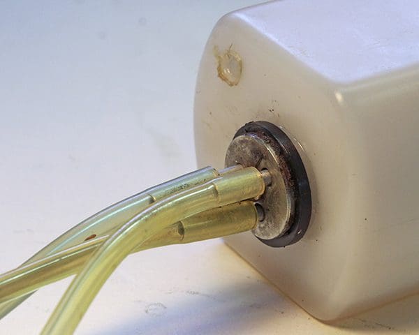

The tank was oily but sound, so I decided to replace all the plumbing. This is cheap and easy with silicone tubing and it gives you peace of mind. However, it is important not to over tighten the tank sealing bung. It is also important to cut the new smaller gauge internal clunk line to such a length that it does not foul the back of the tank wall in any flight attitude.

The fuel tank was sound but needed new tubing in and out.

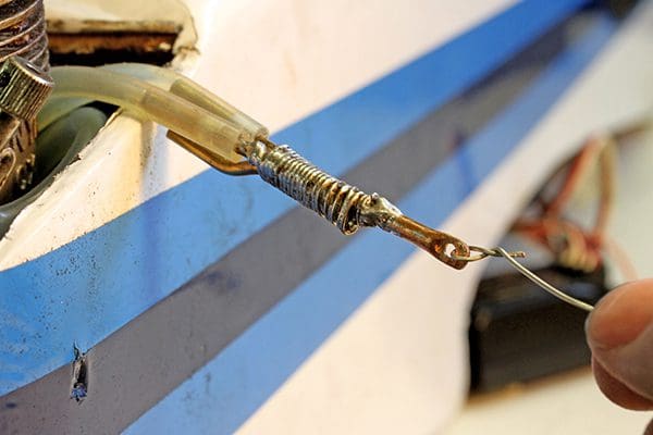

I used three bits of brass rod soldered together to pull the vent, fill and carb silicon tubes thorough the firewall. Or you could just use a short piece of 250V AC mains flex.
june21weekenders25
I used a DIY thingy to re-route the new silicone fuel tubing. Or you could just use a short length of three core mains cable.

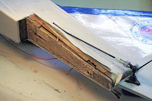

After many, many gallons of airtime with glow fuel the whole of the interior fuselage had a good bit of oily residue on it. I used the meths and baby wipes as best as I could, then a little talc and lots of kitchen towel.
As far as I could ascertain the underlying structure was fine, which was a huge bonus. There were no glue breaks or plywood creaking when I squeezed the fuselage. Frankly, it was built like my grannie’s wardrobe!
