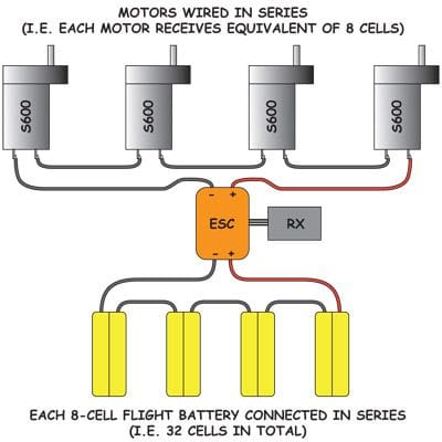

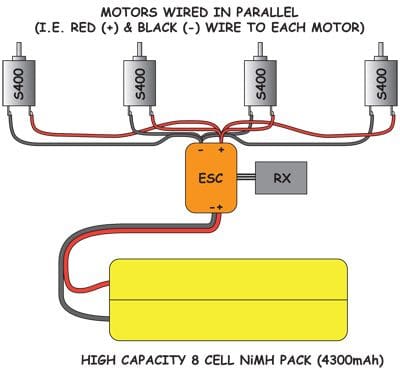

Of course, there are still wiring options to be considered for such a solution; the system can be wired either in parallel (Fig.1) or series (Fig.2), depending on how many cells you wish to use. Series is better for larger numbers of cells, with parallel being preferable for lower cell counts.
Back in the day, most of these setups used the best NiCd and NiMH cells that were available at the time, but there’s no reason why you can’t use Li-Pos here, providing the brushed ESC has programmable voltage cut-off or you incorporate a separate Li-Po saver in the circuit to make sure they don’t fall below their critical voltage (usually deemed to be 2.5V per cell as an absolute minimum).
