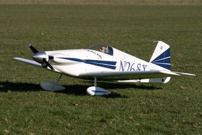

Love this model as I do, taxiing is not one of its strong points and whilst rudder control is both positive and effective, on anything other than very short grass the model has a tendency to tip forwards. As such, I tend to carry her to the strip.
Taking off is a delight with this aeroplane, positive and progressive application of power throwing enough air over the elevator to keep the tail down and as speed increases. Holding the line with right rudder and easing off some elevator sees the tail lift, after which a gentle reapplication sees the model rise gently into the air for a beautiful scale departure. My model rarely leaves the ground with full power applied, it’s just not necessary.

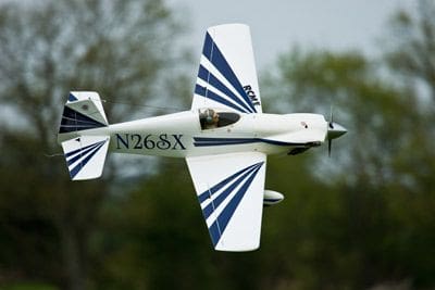

Once in the circuit you’ll find all controls beautifully harmonised and positive. This is an aeroplane that goes where you point it and holds station well. It’s responsive yet not twitchy, powerful but not excessively so. What’s more, handling is delightful and it has no vices. It will stall, but you have to push it quite hard and even then you’ll only detect a gentle drop of the wing which is so very easy to control. These characteristics give the model a broad speed range, though you mustn’t automatically assume that because it’s a racer it’s fast. Don’t get me wrong, it doesn’t hang about but it’s no bullet either.
Rest assured there’s nothing harsh about this aeroplane, in fact, once you’re in the groove it’ll make your flying smooth and accurate. For my part, flowing manoeuvres look best, a gentle transition between each really displaying the model to it’s full potential. Meanwhile, power from the ASP provides vertical performance enough to pull lovely large loops and gorgeous reversals with ballsy, prolonged 45° up-lines.

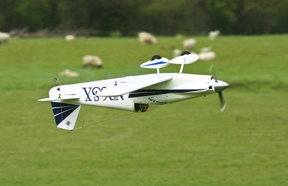

Aerobatically, it’s a peach of thing. A touch of down elevator is required for inverted flight where you’ll find the model almost as stable as right side up. This is an aeroplane that inspires confidence to the point that fin scraping, low level inverted passes become second nature. Trust me, it encourages you to show off, which is exactly what I was doing that day I reduced my inverted pass to wagon rut height and dragged the fin along the deck… this before skidding to an inverted arrival that damaged… wait for it… absolutely nothing!
What else will she do? Well, she’ll fly a beautifully controllable scale-looking flick roll, performs a similarly comfortable spin with a recovery that’s dead easy to anticipate, and will track around a bunt with the best of ‘em. Look at that deep fuselage and you’ll not be surprised to hear that knife-edge flight is pretty good too, though you will need all the available power and be prepared to add down elevator and a tad of aileron to hold the line. I’ve never bothered, but you could, of course, compensate here with a little Tx mixing.
Barrel rolls? Beautiful… and barrelly! Square loops? Square! Derry turns? A delight and nicely crisp, too. Oh, and when it comes to flying a stall turn all I can say is super! I have to gently steer my Mustang with rudder during the ascent (still not perfectly trimmed, I guess), but once up there a bootful of rudder sees her turn tail and perform the nicest of manoeuvres, with just a hint of tail wag on the way down.
