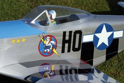

There was a petite problemette in that these days we’ve become habituated to practically faultless covering on our ARTFs and yet, around the fin area, my example looked a bit rushed. Nothing horrendous and not enough to prompt me to recover the joins or complain, but all the same it was a bit below par for a model in this bracket. The supplied fibreglass cowl, complete with dummy exhaust stacks, is a very good sport-scale item, as is the large matching spinner (also supplied). The icing on the cake is the inclusion of a second, see-through cowl to assist you when cowl bashing; you do all your marking out on this without touching the real one until you’re ready – a truly splendid idea!

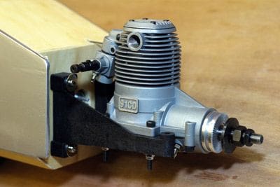

Bearing this in mind, I elected to fit a sexy new RCV .91 four-stoke. I reckoned using this fascinating power plant meant I could kill three birds with one stone by:
● Avoiding the need to cut a big ugly hole for the cylinder head – the RCV is very compact.
● Reducing the amount of subsidiary cowl bashing required by keeping the ancillaries like carb’ projections inside the cowl.
● Enhancing flight realism with the RCV’s distinctive four-stoke sound.
NON-BASHED COWL
Initial trial fits and measurements were extremely encouraging. They showed that the RCV would fit the supplied engine mount provided I dropped the World Models rubber quiet mounts, which are intended to sandwich between the engine and the mount. I quickly realised that the entire RCV would be swallowed up by the cowl, with only simple holes for the exhaust and needle valve being required. I couldn’t believe my luck.

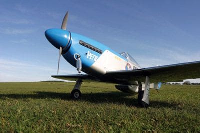

The fibreglass belly pan moulding is a well-made item, though it doesn’t have the scale intake and has to be removed every time you re-fit the wing. It’s slightly fiddly to re-fit each time and, frankly, it could have been better thought out. However, despite the rather un-scale (and somewhat toy-like) shiny silver film finish, I must admit she does look an absolute peach. Maybe the World Models designers were going after a post-war pampered Reno Racer effect. But such was my Mustang’s overall allure, all my mates down the patch commented on how attractive the model looked.

The first job was to stoke up the new RCV. The CD .91 is almost entirely conventional from the outside and can be started in the ‘normal’ way. It was only then I realised that I couldn’t access the cowled-in carb’ for a quick prime, so I choked off the exhaust outlet with my thumb and tugged the prop’ over three times to pull some fuel through. Applying the glow start to the external glow connector I was rather surprised to see it promptly spring straight off. The remote glow connector didn’t match either of my two glow starts – something I hadn’t anticipated in the shed. Fortunately, a flying mate, eager to see the engine start, gave me a different design of glow start, which worked. Try again.
Setting to 1/3 throttle, I applied my tiny Marx epicyclic electric starter to that massive scale spinner, and the RCV turned over very sweetly. The engine gently started and picked up; on opening the throttle it didn’t fade, but it was clearly just a little too rich on the guessed setting of 21/2 turns. I leaned her out a trifle and she ran just fine, throttling beautifully.

Leaning out the RCV a little more, clocking a respectable 8,400 revs on a 14 x 8” prop’, the Mustang was given a girly shove to overcome the initial resistance of the grass. Gareth held in full up elevator to keep the tail down until she was running down the strip, then eased it off until she reached take-off speed, re-applying just a touch until there was daylight under her wheels. She immediately looked completely right in the air – absolutely rock steady and flying effortlessly… very confidence inspiring. All the petty teething problems with the retracts melted into insignificance. It was one of those “Cor!” moments. Then there was the engine note… the sound of a model engine is a very subjective thing, but I thought she sounded absolutely great – a bit gravelly at the lower end, yet clean and four-strokey at the top end; very sympathetic for a fast W.W.II monoplane fighter. The RCV proved perfect for this Mustang, flying it with authority and supplying appropriate power for aerobatics and beat-ups, yet not screaming away like a two-stroke.
On subsequent flights that afternoon the engine / model combination proved itself to be ideal. Gareth reported it to be very well behaved and the glide and low-speed handling were faultless. High praise indeed! As he chucked her about in mock combat, she really did look the part. When I was a nipper I dreamed of radio controlling scale W.W.II fighters, and here was full Technicolor wish-fulfilment.
