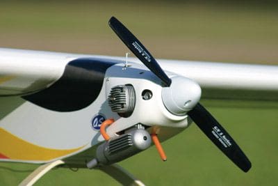

With a new O.S. 46LA two-stroke in the nose my Wot had enough power for good punchy sports flying along with a pretty satisfying vertical climb rate. The suggested starting throws are comfortable enough, and the powerful ailerons induce a satisfying roll rate. The model spins and flicks with ease and recovers well, my example needed only a breath of down elevator to hold inverted flight. The slow speed handling is excellent, and the model will hover (and even fly backwards!) in a strong wind.
