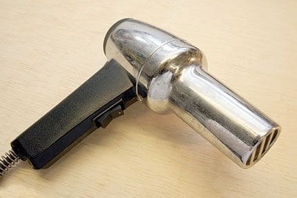

So, I’ve just spent a happy week of evenings covering my model with iron-on high-shrink polyester film. It’s been awhile since last I burnt my fingers with a heat gun, so I was a bit rusty. Let me state straight away that I am not a natural Solarfilmer, Toughloner, or Profilmist. Film covering is one of those blacke artes that seem to take me almost as long as the wood work. Truth be told, I have an irrational dread of cocking it all up. I know that any bad overlaps or folds on the wing tip will be there forever to mock me as a silent reproach. And so, I usually put the task off. However, when I finally tackle it, I’m always pleasantly surprised just how deeply satisfying it is and how enjoyable. Even my tubby, gluey, overweight own-designs look just about okay in the right covering. However, this is only because I’ve learned the hard way. So, here’s my clutch of idiot proof workarounds, sub-techniques and gadgets that speed me on my covering tasks. Fear not however, none of it is rocket salad.

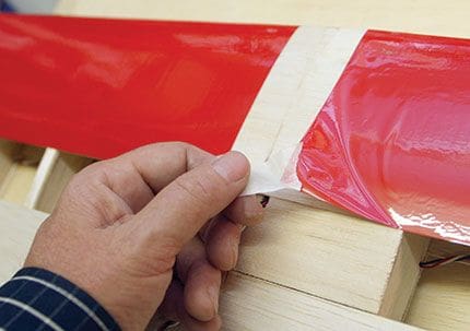

Workaround 5 – Masking tape. Use cheap Pound Store masking tape to hold the film to its marks whilst you iron it down. You can iron through cheap masking tape which will allow the film to adhere to the underlying balsa, yet the tape will still peel away with ease.

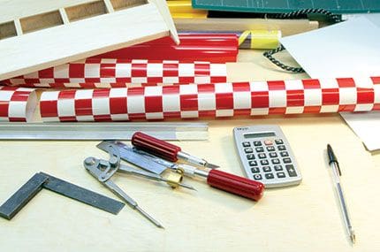

Workaround 8 – Templates. I make card templates for all odd shapes and panels that need to be cut from film. Kellogg’s grade is good, but light A4 card from the stationer’s is better since it’s already cut nice and square. For example, when I wanted to wrap a panel of film from below the wing’s leading edge, all the way around to the limit of the top wing sheeting, rather than attempting to measure it, I just made a card template. This stops guesswork and wastage of film and you can instantly see that it’s right or wrong as you trial fit it around the wing. This done, I lay the template on the film and cut to size. Since most of my basic panel cuts are straight-edged, an A4 size card allows me to accurately mark out each end of a much larger panel, then cut it square in the straight edge machine (see 14 below).

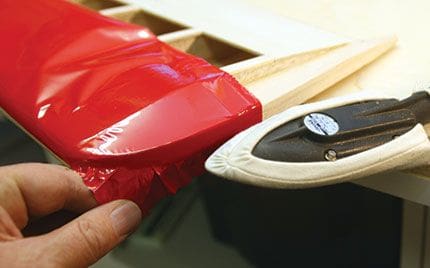

Workaround 11 – Put a sock on it! – Despite its sole’s Teflon coating, your covering iron may pick up messy adhesive, especially with the non-polyester films. If not noticed and cleaned this can transfer to new film, marring the whole job. Go to the model shop and buy a cloth iron sock which will also reduce scuffing. At the first sign of marring, buy another one – they’re less than a fiver.
Workaround 12 – Edge puller. Sometimes you need to pull an edge or overlap of film quite hard whilst simultaneously applying full heat with the heat gun. This can seriously singe your finger tips! My solution is to use a big bulldog clip (its jaws lined with scrap balsa sheet) to give an insulated handle to help you tug the film around a curve or over an edge. Where the bulldog clip is too bulky to use, masking tape is also useful as a film edge puller for a small square edge of a panel.
Workaround 13 – Backing lifter. Sometimes the damned backing film defies all your attempts to peel it off. In this instance, just dab on some masking tape to lift it clear. It works like magic!

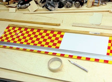

Workaround 14 – Straight cuts. I use a metre length of aluminium carpet kicker extrusion (from B&Q) taped to the cutting board as a cutting guide / straightedge. The clever bit is using masking tape to secure it to the bench top at each end allowing you to slip your covering underneath the extrusion and align it exactly square for that all-important cut. The raised extrusion saves your fingers from the scalpel, too. This is also a brilliant way of cutting chequered panels so that the finished check blocks are ‘open’, and do not display a thin visible line.

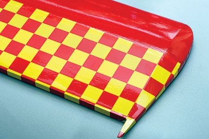

Workaround 17 – Balsa fillets. It’s poor practice to expect film to stick to film without an underlying balsa framework to adhere to. If you’re planning a complicated film scheme with contrasting panels, you may find that in one or two places you need to glue in an extra bit of underlying balsa sheet (or perhaps a fillet) to which the film may positively stick. I found this out recently when I wanted a join line in the film to fall on the hollow of a built up wing tip. Here, then, I just knocked up a couple of balsa fillets and glued them in place. Then, when I came to iron on the film overlap its adhesive had a secure base on which to bite. Mind you, Sod’s Law decrees that you will not realise this necessity until you’re either finalising a complex film design or ‘mid shrink’!
